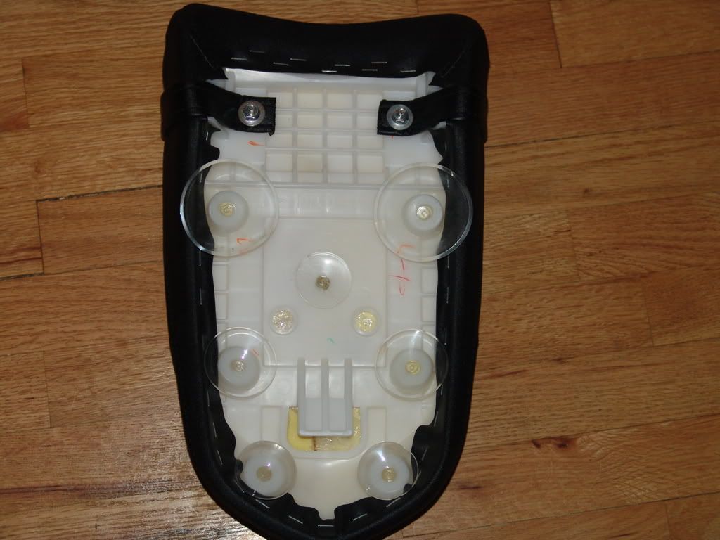

Thanks to desertraider I now have an option for removing the rear seat and replacing it easily in less than a minute and it only cost me $6 to do it. Following his advice I removed all of the rubber bumpers from the factory seat then I went and found some heavy duty suction cups and forced them into the holes where the bumpers were. I also drilled one hole in the senter of the seat and added 1 suction cup for good measure. I just got back from a 20 minute ride with the ol lady and it never moved at all, in fact it was a bit hard to get off until I poped off a few of the cups. For the little bit I ride with a passenger I think this is going to work great. If you are looking for another option I ran across phantom pads and there is another post about them.

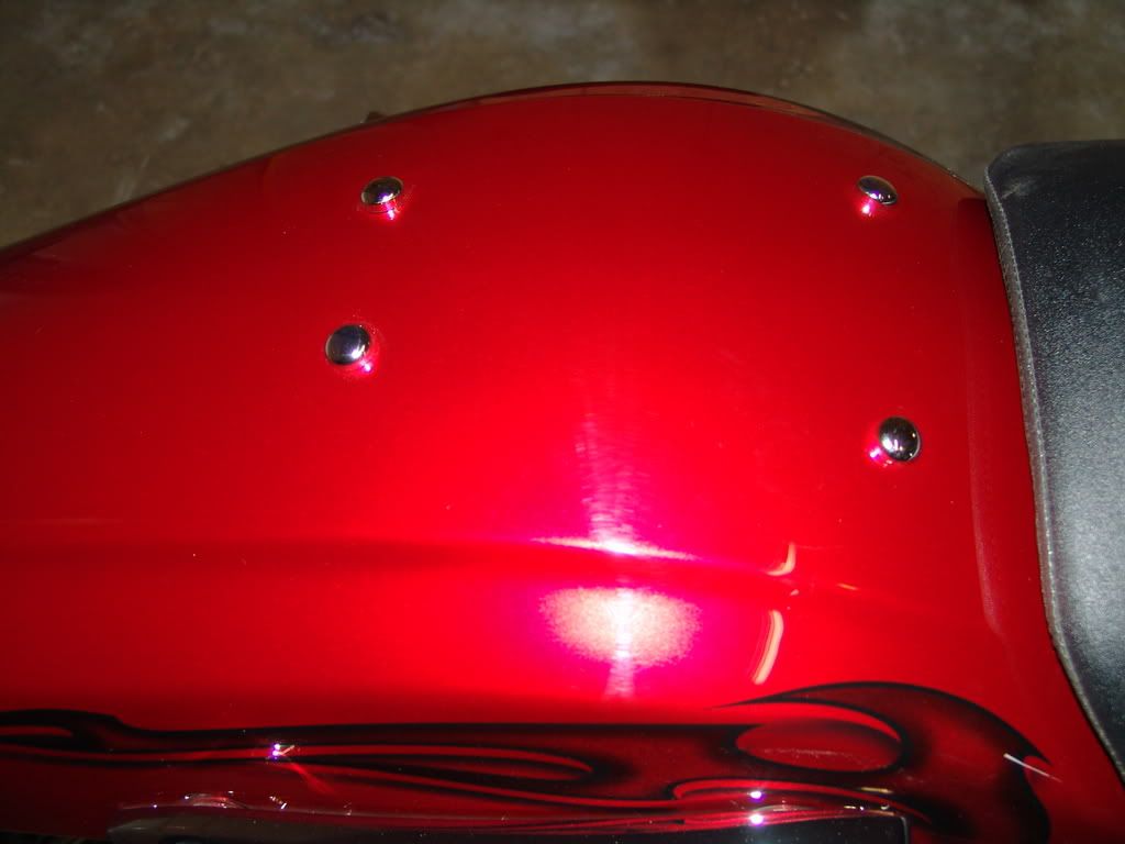

I spent a wopping $1.76 for these 4 nylon tag bolts with chrome caps to fill the holes. Got them at walmart

155 Posts
Now that is some good stuff, don't have to pay a bunch of money to get function, style, and keep momma happy. Was hoping something would come along so I could go from solo to riding with momma in minutes. This is one of the few mods I had in mind, thanks guys for posting the info..... :beer2:

What kind of mods did you have to make to the LEDs? I've seen similar ones from Morton's. They look pretty simple to install. About those crome capped tags bolts. I've been looking for that exact thing. I went to Walmart today and asked 3 employees but still didn't have any luck locating them. What area of the store did you pick them up? Are they metal capped or plastic? Thanks.

They are back in automotive right by all the license plate frames. They are a nylon bolt and nut and plastic chrome cap. As far as the LED blinks I had to install a load equalizer to slow the blink rate and I had to do some grinding on the inside fender brace because the studs on the blinkers were a little short. You will need a pretty long stud to fit through the fender support the fender brace and then the nut that is welded to the brace. I bought these on ebay for around $22 Other than that I just soldered all the connections together and heat shrinked them.
