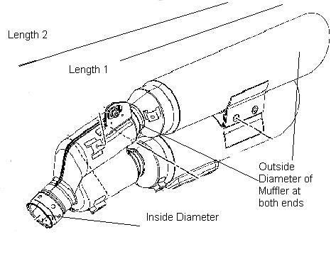

Hey Guys,
Could someone give me the exhaust (muffler) dimensions as follows:
Stock Muffler length 1:
Stock Muffler length 2:
Stock Muffler outside diameter large:
Stock Muffler outside diameter small:
Stock Muffler inlet diameter (where it connects to the EXUP manifold):
I want to purchase some exhaust parts while I'm in the US (nothing available at home).
Cheers,
Scooter

inlet at exup 2.390"
exhaust outer diameter 4.135" both ends
inlet bettween cat's and Muffler is 2.26"
overall length is 29" muffler is 19" top 15" Bottom
cat's are 10" in length
